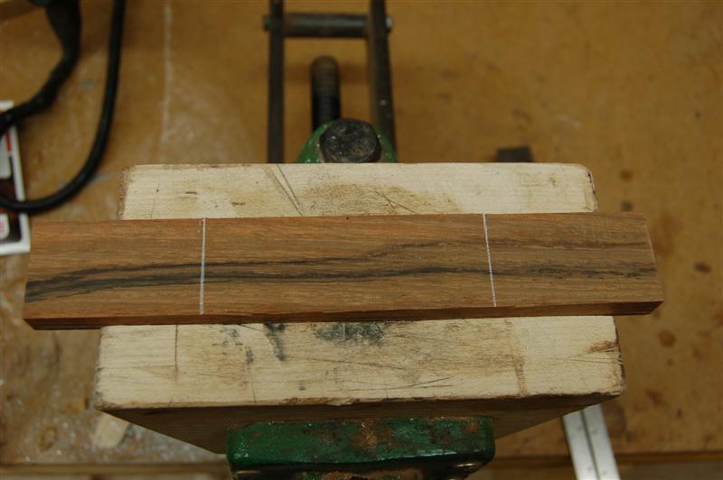

First I cut the blank to exact width and length and flatten or arch the bottom of the blank and draw two lines to delineate the edges of the tie block:

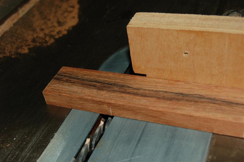

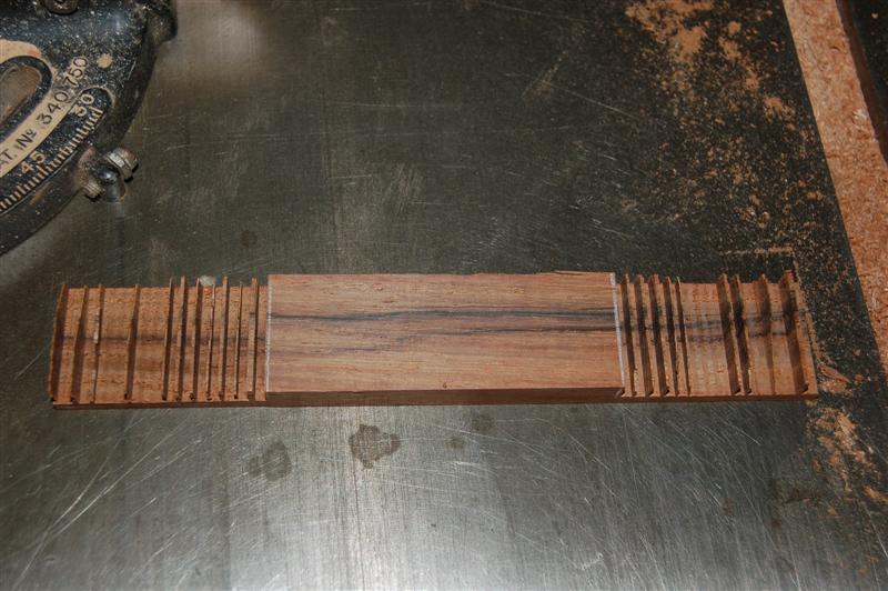

Then I cut at the lines to the depth of my wings (5/16") on the table saw:

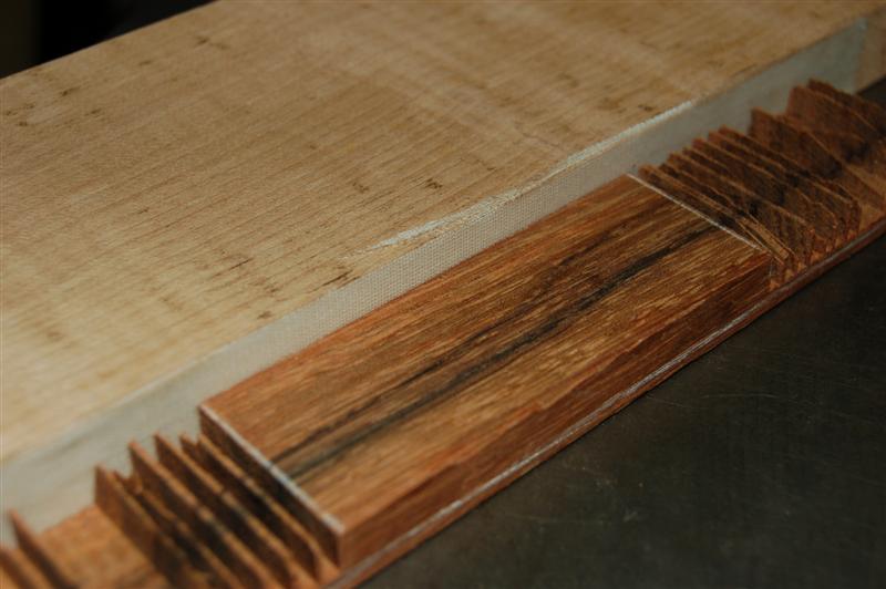

Then I make multiple cuts at that depth to waste away the remaninder of the wood:

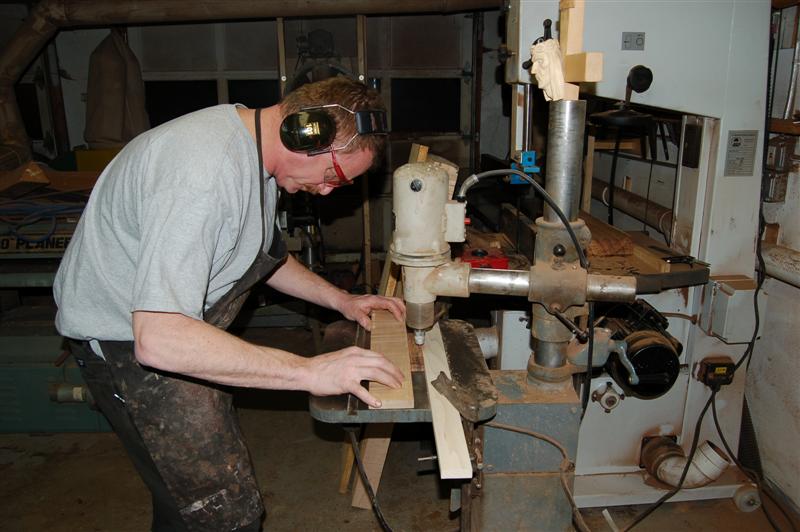

I set the pin router so the saddle slot is 3/16" from the front edge of the bridge-I am using a 3/32" end mill.
Here is a my pin router. It is a 70's vintage Delta with a pedal that raises and lowers the table.They discontinued this machine.I bought it for $400. You can also switch the motor to the bottom and us it as a router table.
Here I am routing the saddle slot:

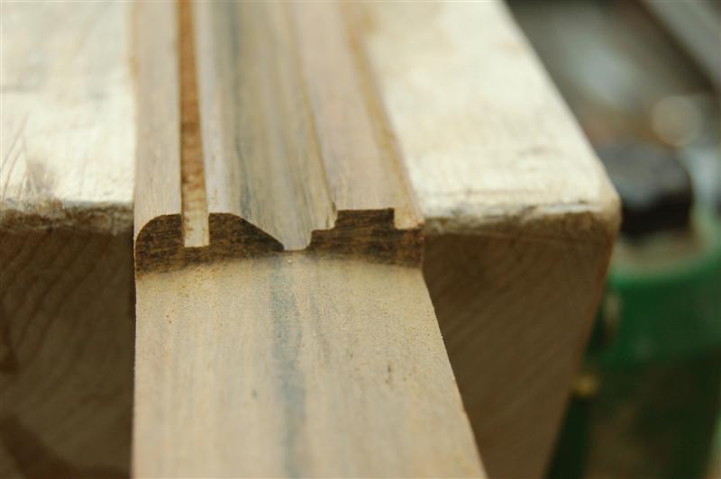

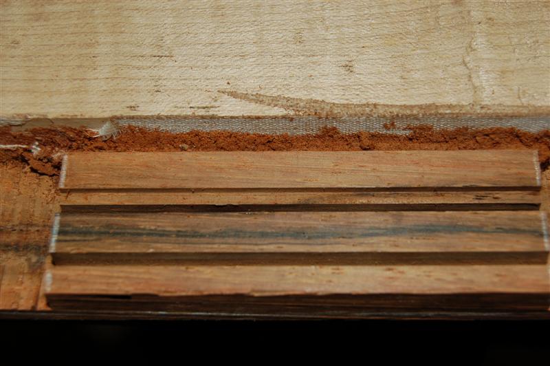

Next I rout two 1/16" deep slots for the tie block inlay:

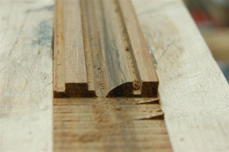

Next,I carve the ramp at the back of the saddle,carve the bridge wings and carve the end facets:

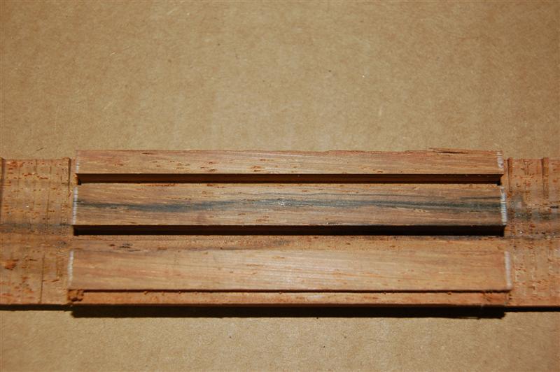

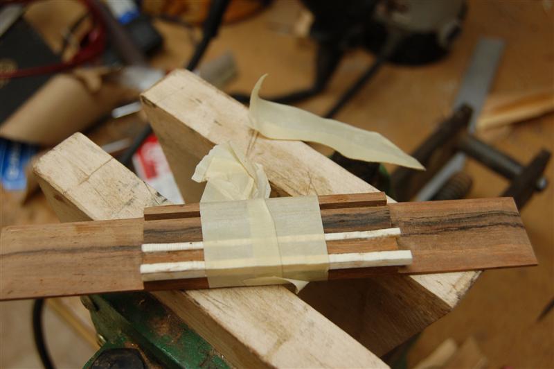

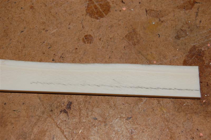

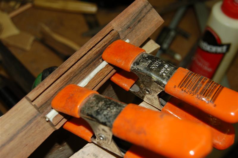

Then I sand two pieces of ivory and glue them into their slots:

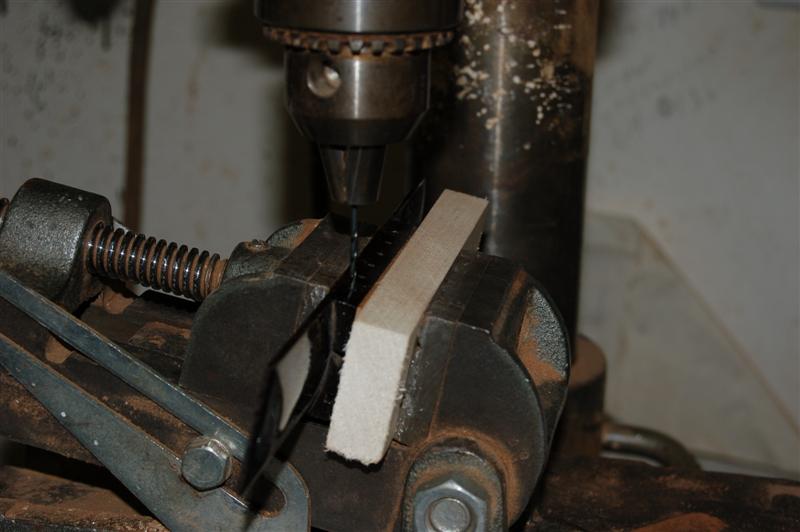

The last step is to drill the holes for the strings.
I use an adjustable vice on my drill press in order to get the correct angle:

Thanks Brad! So, what is the "correct angle" of your string holes? 10deg. seems to be used a lot.
PostPosted: Wed Apr 25, 2007 7:51 am
Posts: 2220
Carlton,
I never measured the angle.
I start the holes 1/8" from the bottom of the bridge and eyeball the angle so the holes emerge at the bottom of the "ramp".
PostPosted: Thu Apr 26, 2007 6:09 am
Thanks Brad. Makes sense.
